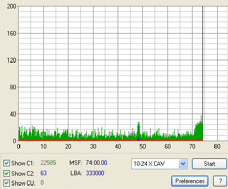

C1 is defined as the sum of E11+E21+E31 per second within the inspection range. The block error rate (BLER) equals with the sum of E11 + E21 + E31 per second averaged over ten seconds. The green peaks in the above Plextools chart indicate the C1 errors found during the reading of the disc.
The red line is the C2 errors of the disc. C2 can correct burst errors as well as random errors that C1 was unable to correct. There are three error counts (E12, E22 and E32) at the C2 decoder. E12 count indicates the frequency of occurrence of a single symbol (correctable) error in the C2 decoder. A high E12 is not problematic. The E22 count indicates the frequency of double symbol (correctable) error in the C2 decoder. E22 errors are the worst correctable errors.
The E32 or CU count indicates triple-symbol, or more, (un-correctable) errors in the C2 decoder. E32 should never occur on a disc.
